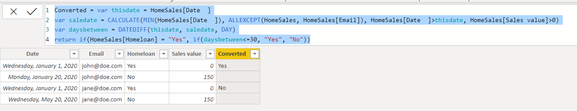

Is there a reason this needs to be done in the query editor?  If not, you can do it as a calculated column (or a measure).  Here is a calculated column expression that returns your desired result.
Converted =
VAR thisdate = HomeSales[Date  ]
VAR saledate =
        MIN ( HomeSales[Date  ] ),
        ALLEXCEPT (
            HomeSales,
            HomeSales[Email]
        HomeSales[Date  ] > thisdate,
        HomeSales[Sales value] > 0
VAR daysbetween =
    DATEDIFF (
        thisdate,
        saledate,
        DAY
    IF (
        HomeSales[Homeloan] = "Yes",
        IF (
            daysbetween <= 30,
            "Yes",
            "No"
Pat

Thanks @mahoneypat. Reason why I wanted it done in query editor is because I put together the data table there through merging and grouping data. However maybe it's easier to create this column as a DAX formula. Your formula works really well! Although for all the rows where homeloan=Yes and no actual purchase was made in the future (i.e. no record of that email adress in the future), the formula also counts it as a conversion. I added this which seems to work:
IF (
AND(
daysbetween <= 30, daysbetween > 0),
Thanks again!
