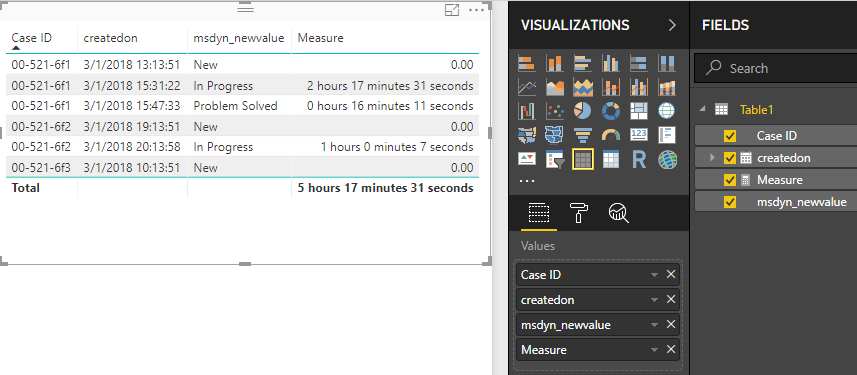

I wonder if any one could help. I am trying to calculate the time period a service activity (case) is in a certain state. however the problem is that although there is a created timestamp there is no end timestamp. there is only a created on timestamp of the next stage of the flow: Hard to explain but will try.
Our service activites go through the following stages:
1 new
2 In Progress
3 Problem Solved
therefore the end date timestamp for "New" would be the created on date/timestamp of "In Progress" therfore using the example in the picture would be 13:13:51 to 15:31:22 therfore 2hrs 18 mins. But not sure this is even possible through DAX or if anyone has any suggestions it would be really appriciated

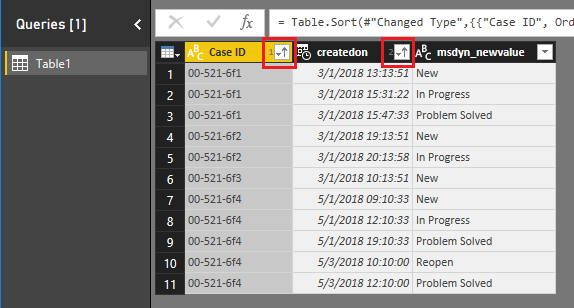

Hi @tmears,
I rethought your data and found all the dates of one case id follow the time line. So there is more simple solution.
1. In the Query Editor, sort the "Case ID", then sort the "createdon".
2. Add an index.
3. Create a measure like below.

Is this the result you wanted? Please check out the demo in the attachment. The old will be deleted.

Hi @tmears,
You can try a measure like below. Please check out the demo in the attachment.

Hi @tmears,
2. Add an index.

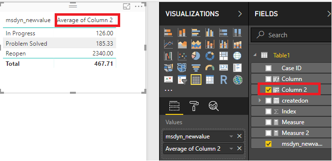

Yes the calcualtions seems to work perfectly, thank you. I just would like to understand the average time across the business for cases in each state, so i can cvalcualte trends etc
Many thanks
Tim
Hi Tim,
I would suggest you use a calculated column. That would be easy to do aggregation.
Column 2 =
VAR index = [Index]
VAR previousTime =
MIN ( 'Table1'[createdon] ),
FILTER ( ALLEXCEPT ( Table1, 'Table1'[Case ID] ), 'Table1'[Index] = index - 1 )
DATEDIFF ( previousTime, 'Table1'[createdon], MINUTE )
Dale
What a man! Dan thanks so much, you really are a start!!
