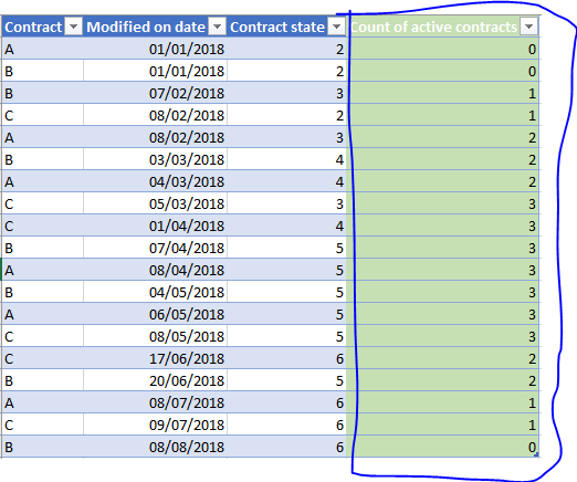

I'm trying to figure out how our active contracts have changed through time, however I can't get the dax correct. Basically I want to count all contracts that are in contract states 3, 4 or 5 at a specific date (modified on). I've achieved the cumulative count, but my measure keeps taking into account contracts that are also in state 6 at the given date, which is not what I want.
Here is an example in Excel of what I'm looking to achieve. (ERROR ALERT: both rows with the date 08/02/2018 should have active contracts as 2 since Contract A became active at that same date). A measure instead of a column would be preferable. Thanks!
Count of active contracts

Basically, if the contract is (up to that date) in contract state 3, 4 or 5, it is counted as active. However, if it is only in state 2 or has already gone to state 6 (up to that date), it should not be counted. Does this help?
Thanks for looking at the problem!
Contract A becomes active on 08/02/2018 and increases the count of active contracts to two.
Contract B is already active as of 07/02/2018 and a change to status 4 on 03/03/2018 does not change the count of active contracts.
Same applies on 04/03/2018 with A as did with B on 03/03/2018.
3, 4 and 5 are all in the state "active". Just a different kind of active.
These are only a few columns of the data, therefore there are multiple "duplicates" in the actual dataset (such as 17/06/2018 and 09/07/2018) because values of oher columns in the dataset change (but those are not relevant here), but I thought it might be good to know when solving the problem.

BTW I just noticed a error in my example data. Both rows witht he date 08/02/2018 should have active contracts as 2 since A became active at that same date, sorry!
