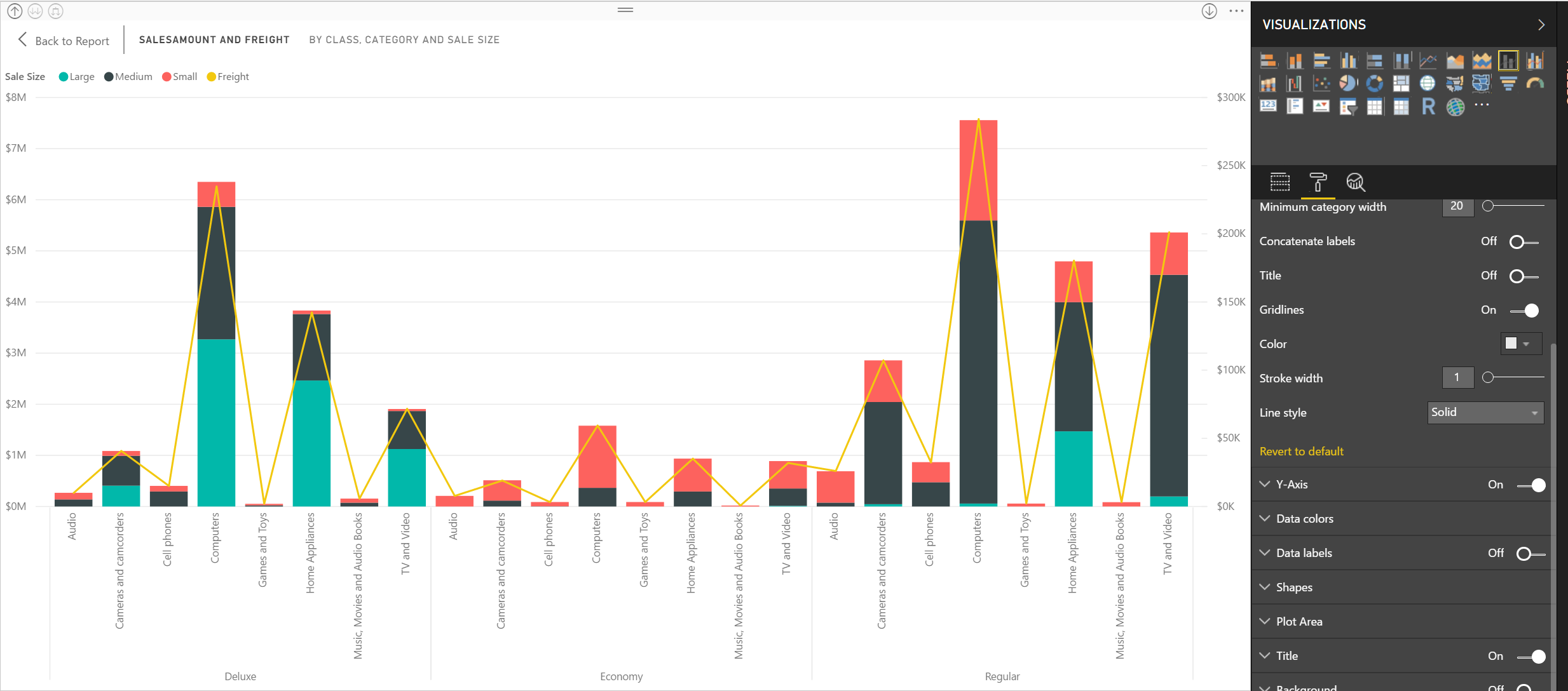

concatenate x-axis does not work for all char types?
The new feature to turn off concatenation does not work for all chart types such as the Line and Stacked Column Chart.
Does anyone know if that is a bug and they plan to fix that or...?

It does not seem to work for the combined line and stacked chart though:
Neither of those seem to support it 😞

Hi @OneWithQuestion,
Sorry for the late response.
I go the feedback from PG today, they said:
"This is a bug with a simple fix, we added this feature to the capabilities file for line and column but seems we forgot to add one line to enable this for comboCharts. We will fix ASAP."
