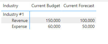

I have a Power BI matrix where I have the field "Scenario" as my Columns, the field "Industry" as my Rows, and two Values, Revenue & Expense, which are both calculated metrics. However, I have enabled the feature to switch values to rows.
The "Scenario" field has 2 values: "Current Forecast" and "Current Budget".
Currently, the end result of the matrix visually looks like this: It has Two columns called Current Forecast & Current Budget. It lists all the industries as Rows, and under each industry, are two rows for Revenue and Delivery Expense related to that Industry.
I want to adjust my matrix to be able to visually have a third column showing Variance to Budget, where it subtracts the Scenario field from each other (Current Budget from the Current Forecast). I want to leave my existing values as rows.
My end result should visually look like this:
It has Three columns called Current Forecast & Current Budget & Variance to Budget. It lists all the industries as Rows, and under each industry, are two rows for Revenue and Delivery Expense related to that Industry.

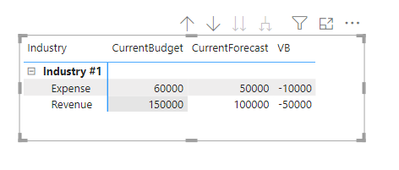

After my testing, the following methods can achieve the effect you want for your reference:
Create several measures as follow
CurrentBudget = CALCULATE(SUM('Table'[Amount]), FILTER('Table', [Scenario] = "Current Budget"))CurrentForecast = CALCULATE(SUM('Table'[Amount]), FILTER('Table', [Scenario] = "Current Forecast"))VB = [CurrentForecast] - [CurrentBudget]
Output:

@Anonymous
Attached is a picture of sample data, along with what it currently looks like. I've also shown an image from excel of what I'm trying to get it to do.
Hi @JadenWelch
Output:
