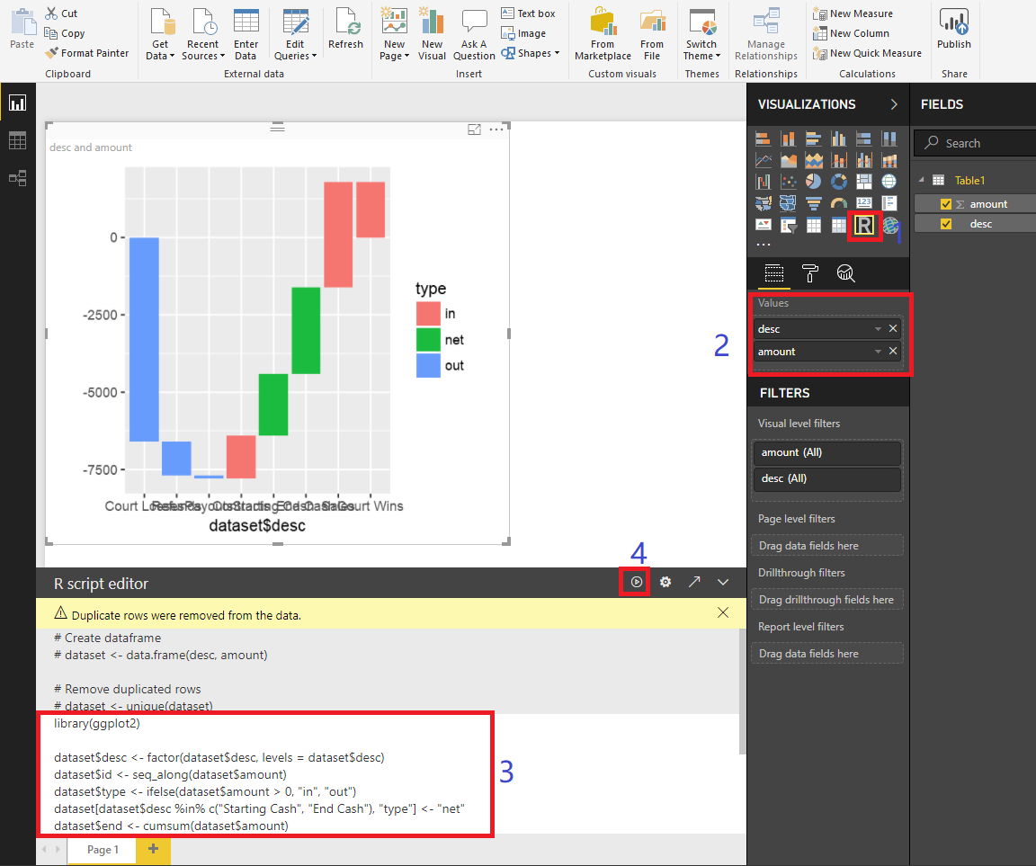

Hi All,
I want to write an R Program to create waterfall chart in Power BI. The reason I want to write is I don't want to show Total bar  as  the default waterfall chart in Power BI has.
So I have two columns in the dataset ( Category, Metric).
So the metric should split the data based on the category and plot it as waterfall chart showing the positive and negative values.
If I use ggplot2 I need to paas various arguments and not nececerraily I have all the arguments in the power bi dataset.
But using the columns I have , i want to create all other aguments.
And somehow I am not very clear on the syntax,
I am following the below blog and trying to replicate in power bi.
https://learnr.wordpress.com/2010/05/10/ggplot2-waterfall-charts/
Any help to show such example would be really appreciated.

Hi @akj2784,
You can paste the R script and run it directly. If there is an error that could say lacking of packages, just install it.
The demo code from your link.
library(ggplot2)
dataset$desc <- factor(dataset$desc, levels = dataset$desc)
dataset$id <- seq_along(dataset$amount)
dataset$type <- ifelse(dataset$amount > 0, "in", "out")
dataset[dataset$desc %in% c("Starting Cash", "End Cash"), "type"] <- "net"
dataset$end <- cumsum(dataset$amount)
dataset$end <- c(head(dataset$end, -1), 0)
dataset$start <- c(0, head(dataset$end, -1))
dataset <- dataset[, c(3, 1, 4, 6, 5, 2)]
ggplot(dataset, aes(dataset$desc, fill = type)) + geom_rect(aes(x = dataset$desc, xmin = id - 0.45, xmax = id + 0.45, ymin = end, ymax = start))

Thank you for quick reply.
Assume desc variable is already present in my dataset which I have added from power bi fields. How do I refer that column in the calculation for the last line shown below.
I don't want to create a variable for the column which I already have it in my dataset.
 Also if you can suggest any way to stack the bar on some other column.
Any help would be really appreciated. I know this is more of R question but just in case you have the answer handy.
