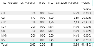

Hi, I'm trying to calculate the total weight (61.45%) as a measure, so later I could divide other columns by that value (0.6145). It's similar as having %GT but as a measure for calculations.
Any insights?
Normal WeightNormal Weight%TG Weight%TG Weight

The problem with this is that when I try to use it later as a total grand sum, it calculates the SUM ( weight) for each row, and not as a total.
