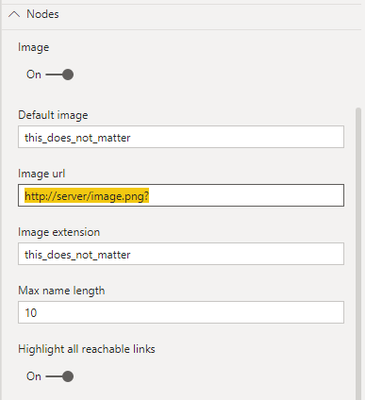

The whole point of this is to let you build an image URL based on the node type.
What if you just want one image (not to build the URL based on type)?
SOLVED: Just put a question mark "?" at the end of the URL. Like this...
Yes, the docs could be more clear.
// Jerry
