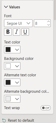

Hi Team,
I have a table visual in my report as below:
I wanted to middle align the text values which means not centre align. Currently they are left aligned, which is okay. But i want them to be on middle of their respective cells. The values section on format pane don't have any such option.
My expected place of text is highligted as below in yellow:
Any option that you can suggest to modify this?
Thanks in advance!

Hi @sivarajan21 ,
You are correct my apologies.
There is an option to add padding to the rows but this impacts the full line not just a specific column.
Regards
Miguel Félix
