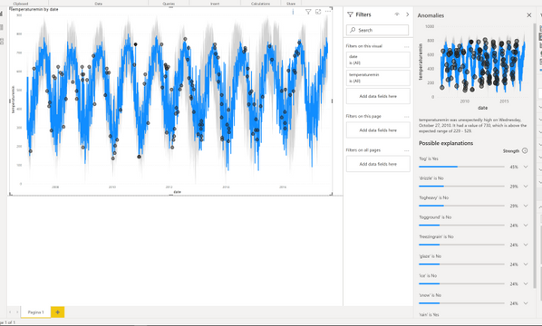

Everything is working for me, until I click on an anomaly:
Its a blank report with just date in the axis and revenue in the values.
This is without adding anything special to the overview. I tried it with 3 different reports that had different datasets, all with the same results. What am I doing wrong?
Version: 2.88.621.0 64-bit
I have the same problem when in Desktop mode, but it works when I publish to https://app.powerbi.com/.
Does it work for you when you publish?
If so, why doesn't work in desktop mode?
Is it feasible to share a repro to us?

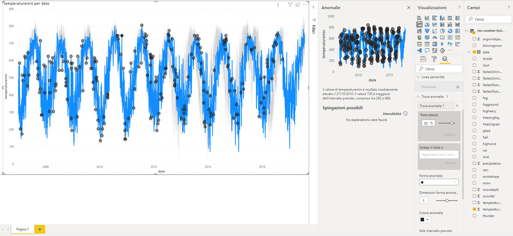

Hi to everyone,
I found some exemples on internet to test anomaly detenction.
I send you the link of one:
https://radacad.com/anomaly-detection-in-power-bi
I followed every step but the explaination panel alweys show me the same message:
"No explainations were found"
I send you the pbix that I used
https://1drv.ms/u/s!Aq9vs57jlUsQgxc3QKRh8CyXhaPJ
Can you tell me what's wrong?

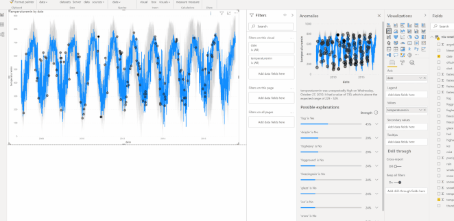

Hello @I365SvcUsr , I see from your pbix that you are trying to explain by just two fields. If you remove these fields from the explain by field well, our automatic field selection will kick in and allow you to find explanations on more points. You can also try dragging more fields to the explain by field well.
Additionally, it is expected that some anomaly points won't return explanations, because there simply isn't enough information to explain that point with confidence.
i tried to remove all values from the "explain by" field but nothing changes: the explanation panel is always empty.
I also selected the same date of the example that I sent you (27 october 2010).
Can you show me what you see selecting this date into the pbix that i sent you?
I did see that some edits were made to the data in this pbix so that it no longer matches the data given in the tutorial you linked, so some results may be different. However, I get quite a few explanations returned in the pbix you sent when I click on the anomaly point at 27 October, 2010 and have no fields in the explain by field well.
Can you try closing the pane, removing the anomaly detection card, and applying anomaly detection again? Then check if you can get explanations for this point.
If not, can you create a new pbix using the data directly from the tutorial at https://radacad.com/anomaly-detection-in-power-bi and try again? That way we can check if you are able to get explanations results at all.
I wanna explain you every step I did this second time:
I uninstalled and installed PBI Dextop. After that, I downloaded again the .CSV from the linked tutorial and I imported it into a new pbix. I checked the option "Anomaly detenction" so I closed and opened the pbix.
At this time, I clicked on the line chart in the visualization panel and select thedate for Axis and temperature into Values, so I applied anomaly detection without fields in the explain by field.
The result is the same:
https://1drv.ms/u/s!Aq9vs57jlUsQgxhyFhRlDFHpDGBs
Nothing appears..
