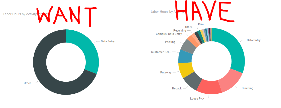

PROBLEM: I have a bunch of labor data composed of different "activities" or tasks. I want to display a donut chart that reflects the percentage of that activity's labor to total labor for all activities. On this same report page, I have a labor hours over time bar chart, to see trends in total labor for each activity, SO, I have an activity slicer, so that you can select whichever activity and view the trends.
WANT: I want the donut chart to change, in addition to the trend bar chart, whenever I change the activity slicer, so that the donut chart shows ONLY the selected activity vs all other labor hours. Here is a picture of what I want vs what I have.
The only way I was able to create the one on the left, was to select the "Data Entry" activity, right click and say "Create Group." Then, it's Data Entry vs all Other. However, I would have to create a seperate column for EVERY activity so each one would be in it's own group, but then the slicer wouldn't work because it's just for activitiy general.
Can anyone help me out? I'm sure it's something simple. Please don't tell me to just not use a donut chart. lol.

I want to post another example of what I'm trying to achieve in case I didn't explain it sufficiently before. So, my report is like this:
The bar chart shows the sum of labor hours, filtered by activity through the slicer, by week ending periods. The pie chart shows the sum of labor hours for the selected activity, versus, the sum of labor hours for all other activities. (A bonus would be if you clicked on a bar in the chart, it would filter the totals in the donut chart for just that week ending period)
Then when a user selects another activity from the slicer, the donut will show, again, the selected activity vs. all other. Like so:
It's almost like a "dynamic grouping" or something, I dunno.
What do y'all think?
