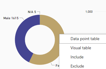

https://i.gyazo.com/0fcd1722a0ca30c4980eb93ef13367c6.png
Upon right clicking a point in the pie chart above, there was an option to click "Data Point Table", which leads the viewer to a view where they see the entirety of the underlying dataset in table form.
We don't want the report consumer to be seeing this, they should only see the pie chart on the front-most end.

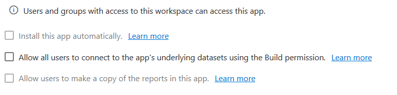

In the App permissions, all the relevant permissions were turned off:
 https://i.gyazo.com/595e6b78774ffc6fe931ec3928682a4e.png

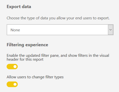

Under Reports -> Settings, the 'Export Data' option was checked off too:
https://i.gyazo.com/34117d4a9768a56c61e12d9abe747b0c.png
So I can't put my finger on what it is we were missing..

Hi @rainynights,
check you Report settings at Power BI Desktop.

Hi again @mwegener!
It looks like that's not it - I've turned off data exporting permissions on both service, as well as in the file settings in desktop.
But this hasn't fixed it!!
