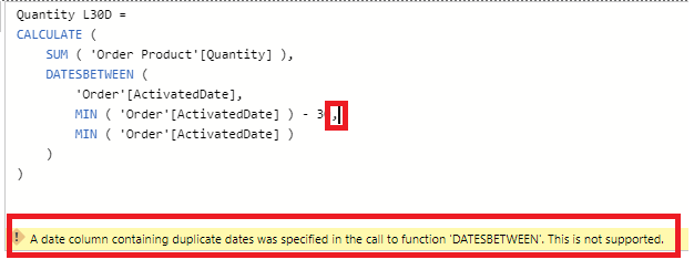

Hi @dennisdepoorter,
It's quite strange. I saw a dot rather a comma after "30" when I opened the report. I changed it into a comma. It ran into another issue, which can be solved easily by adding a Date table or using a formula like below.
Quantity L30D =
    SUM ( 'Order Product'[Quantity] ),
    DATESBETWEEN (
        'Order'[ActivatedDate].[Date],
        MIN ( 'Order'[ActivatedDate] ) - 30,
Relative_date_filter_true_DAX2
