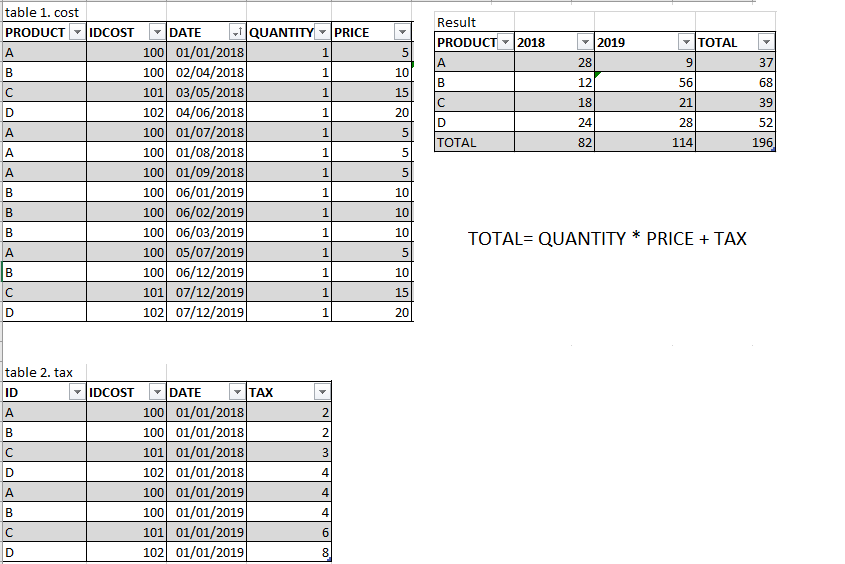

I have two tables, one of "Cost" and one of "Taxes", in the latter the "tax" column is updated every year.
also the column that I have to relate both tables is "IDCOST".
The first problem is that I tried the "Many to many" relationship and it didn't work.
I want to relate both tables to get a final result as shown.
that is, calculate the tax according to the year of the date column.

hi, @ybatistamayo
For your case, you don't need to create the relationship between two tables, just try this formula to create a measure:
Result = var _table=ADDCOLUMNS(COST,"_Tax",CALCULATE(SUM(TAX[TAX]),FILTER(TAX,COST[IDCOST]=TAX[IDCOST]&&YEAR(COST[DATE])=YEAR(TAX[DATE])))) return
SUMX(_table,[QUANTITY]*[PRICE]+[_Tax])
Result:
and here is sample pbix file, please try it.
Lin

Very interesting qns for something seemingly straight forward.
If i get what you are intending to do, can i say for each IDCOST, the ID is not important , its only the year:
100 is 2 in 2018 regardless of A or B
100 is 4 in 2019
101 is 3 in 2018.
If that is the case, in table 1 , let newIDCOST= Year&IDCOST ( example 2018_100) , do this in source or power querry
in table 2 concatenate this to newIDCOST,Tax
2018_100, 2
2019_100,4
2018_101,3
(remove duplcates is necessary(after removing column ID, row 1,2 would be same)
create a 1 to many relationship from table 2 to table 1.
to be neat you can have a seperate calendar table or if your table is not too complicated just have a year column in your table 2.
regards

when you put cgo tax to values ​​in the matrix this is what happens
what I want is every year to show the correct tax
I'm sorry I'm sorry, I'm wrong to type, the right thing is that each product is assigned an IDCosto
A 100
B 103
C 101
D 102
