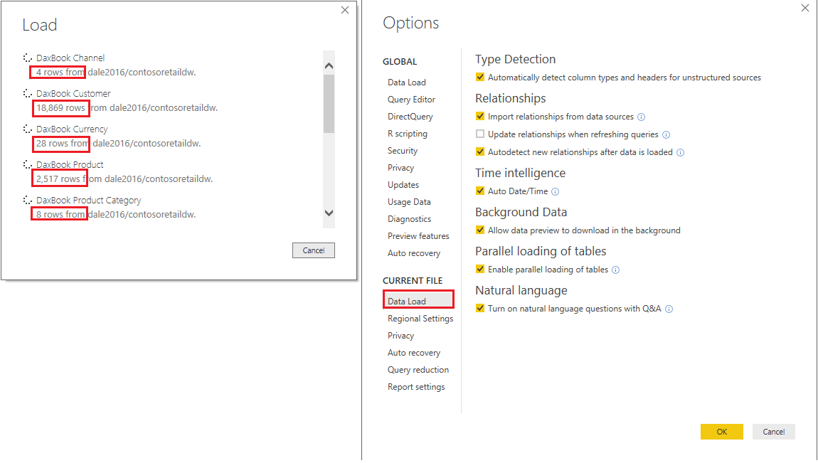

It looks like nothing special loading queries. The queries can be loaded concurrently.

In the following video there is a possible solution:
https://www.youtube.com/watch?v=YfdypVSYb9c
After disabiling the concurrent refresh ([!] I have not tested the effect upon performance of doing this), next you can add an M Code function function.InvokeAfter in the advanced editor.
I think that you could set it up where the function that is called "daisy chains" through the load order you're interested in.
