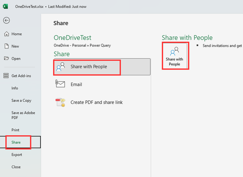

Alternatively, could you try this other avenue with your actual file:
1. Generate a 1drv.ms embed link by any means. Just to try something different, I did the following:
(a) Open the Excel file in the browser
(b) Select Editing > Open in Desktop
(c) In Excel Destop application, File > Share > Share with People > Share with People
(d) Configure as "Anyone with the link can view" and select Copy
(e) This creates a 1drv.ms link:
2. Paste the 1drv.ms link to the browser.
For me, this redirected from
https://1drv.ms/x/s!Aujav0_KPzBhgesudAcfkGDbMJVx2g?e=lobMac
to
https://onedrive.live.com/view.aspx?resid=61303FCA4FBFDAE8%2130126&authkey=!AHQHH5Bg2zCVcdo
3. If you end up with such a link, change view.aspx to download
https://onedrive.live.com/download?resid=61303FCA4FBFDAE8%2130126&authkey=!AHQHH5Bg2zCVcdo

Thanks for the update 🙂
When creating a sharing link from Excel Desktop, could you check that it is set to "Can view" rather than "Can edit"?
For me, the resulting 1drv.ms URL redirects to
https://onedrive.live.com/view.aspx?resid=<ItemID>&authkey=<AuthKey>
If that doesn't work then I'm really not sure.
There are ways to create an embed URL for OneDrive Personal using the Graph API but that's beyond me at the moment.
Hope you can get it working somehow! 🙂

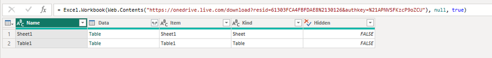

5. Connect in Power Query:
= Excel.Workbook(Web.Contents("https://onedrive.live.com/download?resid=61303FCA4FBFDAE8%2130126&authkey=%21APNVSFKzcP9oZCU"), null, true)
One thing: try clearing the credentials and resetting to Anonymous. At least that worked for me.
