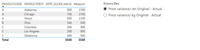

Hi There,
I am trying to build a calculaion to identify the total sum of values of product code. In tableau, we do use, {FIXED [PRODUCTCODE]: [SORT_SLICER_VALUE]}. But in power BI, I have wrote the same like below
output = CALCULATE([SORT_SLICER_VALUE],ALLEXCEPT('ProductMaster',' ProductMaster'[PRODUCTCODE]))
SORT_SLICER_VALUE = SWITCH(SELECTEDVALUE('Slicers Des'[Slicer Des]),
"Price variance/ kg Original - Actual", [Price variance/kg Original - Actual],
"Price variance/ ctn Original - Actual", [Price variance/ctn Original - Actual])
But this calculation returns the same disaggregated value in the [SORT_SLICER_VALUE] measure. As an example,

SELECTEDVALUE('Slicers Des'[Slicer Des]) , this is what you have used to impact on allexcept but in the table it is not appearing, have you used it as a slicer externally!

@VijayP  Exactly. I have created an extrernal table. Based on that table the slicer is determined. So is there any work around to do this ?

@VijayP  thank you for the comment. Actually the required outcome is mentioned in the table i have provided. I will paste that one here as well. Pls refer the final column.
