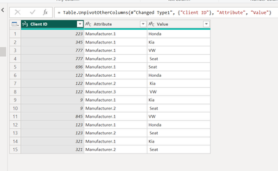

Hi @clim2f88j ,
1. Select the Manufacturer Column and Use Split by Delimter to split the entries ("Comma" delimiter to be use with each occurence"
2. Post which the data would look like this
3. Now, select the 3 manufacturer columns and click on Unpivot Columns as shown below
4. After doing step 3, this is how the table will look
5. Remove the Attribute column and rename Value to Manufacturer. PFB the screenshot for the same
6. Select the Manufacturer Column and Trim it using the Format Drop Down to remove any unwanted spaces in the names. This will help iwth grouping the column for getting the count and percentage
