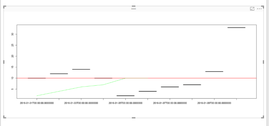

Hi @lalthan,
I tried this one but am getting odd results. Refer below screenshot:
After adding below line, it happens
plot(x = dataset$Date, y = dataset$Temperature,type = "l",col = "blue")
Any workaround?
