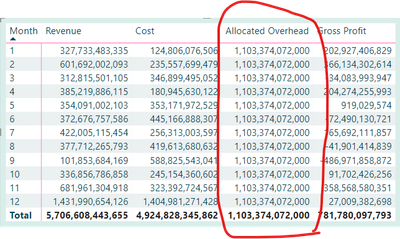

but when I try to use this measure in my transaction table, it doesnt filter the projects
I now the problem is from my data Model, but please tell me how to fix it and what is the best data model for these kind of related tables.

the next Measure I created is:
Allocated Overhead = CALCULATE[Overhead Expenses],  ALL( '00- JV List'[Month]))*[Percent of total]
Overhead expenses is also a measure:
Overhead Expenses =
CALCULATE(
    [Amount Dr (CR)],
    '00- JV List'[Title1]="Operational Expenses",
    '00- JV List'[Title4]= "Tehran Office"||
    '00- JV List'[Title4]= "Tenders"||
    ISBLANK('00- JV List'[Title4]||ALL('00- Persian Month'[Persian Month])))
here is the relationship between tables:
Kindly Please advise.
