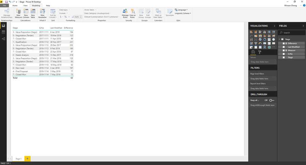

Can someone help me out with the datediff measure for a list of different Stages and different Quotes
Have a look at the screenshot below

Your measure does not give an accurate result. See the screenshot below.
I need the first row in the (Diffrence Collumn) of every new Q No to be empty; start of new start stage change, just like my ealier posting !

Hi @v-yuta-msft,
Appreciate your sharing.
However, when I used measure for Index By Q No, I have multiple tables. I have trouble finding EARLIER function in my table and "Dense" is gray out. Refer photo screenshot:-
