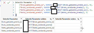

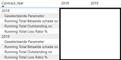

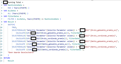

I've created a matrix table which includes a measure and a parameter connected to it.
However whenever a certain parameter is selected I want the measure to not say 'geselecteerde parameter' (selected parameter in english) but the actual name of the selected parameter. The parameter is selected through a slicer. I can't figure out how to do this.
Below the matrix table:
measure:
Parameter:
In short whichever parameter is selected in the slicer, that name should be the name in the matrix.
Is there a way to make this happen?
Thanks in advance for any help.
Hi @Bobv013 ,
Thank you for reaching out to the Microsoft Fabric Community forum.
1. Create a dynamic label measure
Selected Parameter Label =
VAR SelectedParam = SELECTEDVALUE('Selectie Parameter'[Selectie Parameter])
SWITCH(
SelectedParam,
"Bruto_geboekte_premie_os", "Bruto geboekte premie os",
"Bruto_verdiende_premie", "Bruto verdiende premie",
"Netto_geboekte_premie_os", "Netto geboekte premie os",
"Netto_verdiende_premie", "Netto verdiende premie",
"Geselecteerde Parameter"
2. Replace "Geselecteerde Parameter" with this measure Geselecteerde Parameter
To replace that label dynamically, In your matrix visual, remove the existing static row name. Add a new calculated measure placeholder row.
Dynamic Value Measure =
VAR SelectedParam = SELECTEDVALUE('Selectie Parameter'[Selectie Parameter velden])
CALCULATE(SELECTEDPARAMETERMEASURE)
Note: Replace SELECTEDPARAMETERMEASURE with your measure switch depending on the parameter selected. Use the Selected Parameter Label as a row value instead of hardcoding “Geselecteerde Parameter”.

Hi @Bobv013 ,
What you’re asking for—dynamically changing the measure name in the matrix based on the selected parameter—is a common challenge in Power BI. By default, Power BI doesn’t allow dynamic renaming of measure titles in visuals. However, there are some workarounds you can try to achieve a similar effect:
Option 1: Use Field Parameters (Dynamic Titles in Matrix Columns)
Option 2: Dynamic Titles Above the Matrix
Selected Parameter Name = SELECTEDVALUE('ParameterTable'[ParameterName])
Option 3: Unpivot Your Data and Use Categories
Important Note:
Currently, Power BI does not support fully dynamic column/measure names inside visuals based on slicers or selections. The above options help you get as close as possible to your goal.
References:
If you need sample DAX code or a step-by-step on any of these workarounds, let me know which option you’d like to try.
