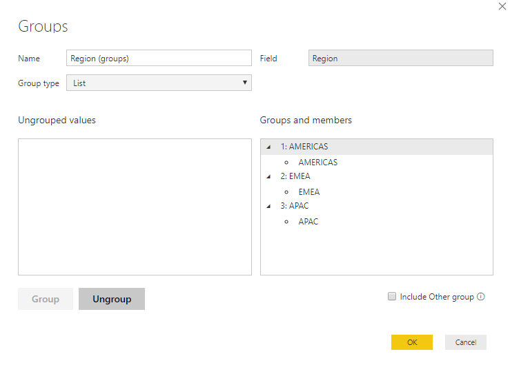

Here is what I did:

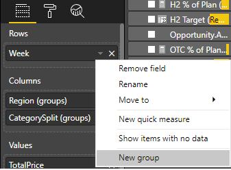

I built my matrix table, then I clicked on the "Columns" dropdown, then clicked "New Group":
From there, I created one group per value - Important here: Name the groups with the index prefix ( ie. 1:, 2:, 3: 😞Once complete, the columns come in with the prefixed index. This will sort based on the index you specify in the grouping.
This is nice and clean because it doesn't affect your data for filtering, grouping, etc, and is pretty simple to implement.
Thanks its work like a magic
Perfect! Thanks so much! 🙂
Thank you! I worked very well for me.
