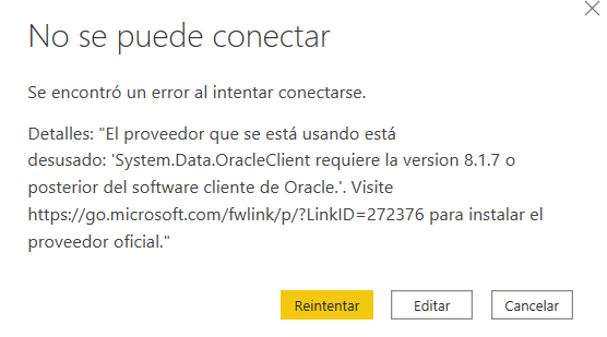

Dear guest, together with greeting, I indicate that I read all the posts in this forum that speak of this topic and have not been able to connect to the oracle database. What I've done:
1) I have the Power BI 64 bit and download the ODAC122010Xcopy_x64
2) Install it as follows: install.bat all c: . . . . . . . . . . . . . . . . . . . . . . . . . .

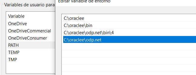

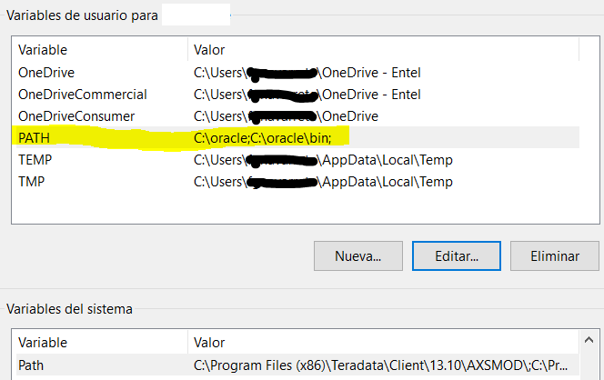

3) Since none of the above steps worked either, I went and added my ENVIRONMENT VARIABLES since the installer does not indicate anything and some people indicated that if I work for them, being like this: (only environment variables, in system variables I have done nothing )
4) I've done what's on the community links, but I haven't done well ... the error continues

Thank you very much for your answers, unfortunately it did not go well with any solution, in the end I downloaded an application uninstaller, uninstall absolutely everything and with it cleaning the regedit, then install the ORACLE v12c and I worked everything, wonders and WITHOUT ENVIRONMENT VARIABLES, run it and connect it immediately.
Quite strange the behavior, I think it must have influenced the regedit or so many drivers and apps that I installed for the oracle and might have soiled the connection, but now it's resolved.
Thank you all very much.

I've already seen your information and I've already tried it, but the result is exactly the same.
I have those same environment variables which was what I installed in the folder and it doesn't leave me, it gives me the same error 😞
