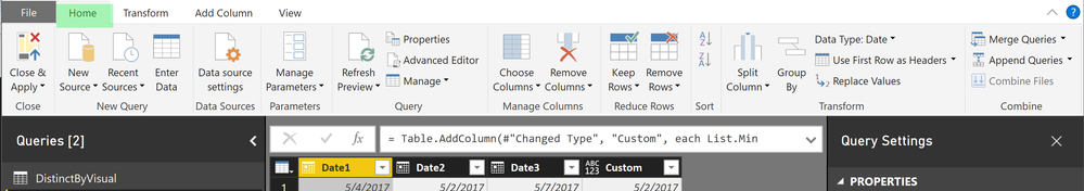

Step 1
Connect to your table from company 1 and make all your transformations
Step 2
Connect to your table from company 2 and make all your transformations
Step 3
Go to Query Editor
Step 4a
Mark one of the Queries and in the home tab
Step 4b
choose the appropriate Append option
Step 4c
choose the table to append
Hope this helps
