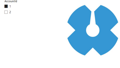

Based on your description, I have created a simple sample:
First, create a Measure to display the image you want to display when nothing is selected(The DAX is the base64 code of the image)
Then create a measure:
Measure =
SWITCH(TRUE(),
ISFILTERED('Table'[AccountId]),SELECTEDVALUE('Table'[Show profile]),[Blank Value])
Final output:
Measure =
SWITCH(TRUE(),
Final output:
