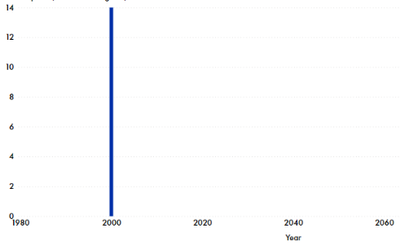

I have a calculation where for all years I divide the value of a given year. This needs to be done at a group "sector" level.
When I put the measure in a visual with the "sectors" in the legend of the visual, the calculation works fine:
However, now I want a visual with the total, so not showing the values per sector. To do this I thought it would be best to use a summarize function.
However now the problem is that I am not able to get rid of the year context within the summarize function. I tried to use the crossfilter function with setting it to none. So the value is now only shown for the "given year"= 2000 (for 14 sectors):
Any help is much appreciated!

  • Hi Anonymous ,
    Sorry maybe I'm not very clear about your problem, in my understanding, before you put the sector in the legend, now you want to show the total instead of per sector, can not directly remove the sector from the legend work?
