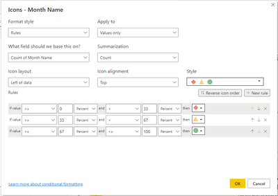

How to put conditional formatting on text ?
I have this table and I would like to put icons according to the state :

    Hi Anonymous ,
    You could create a measure to use numbers to represent different states.
    Measyre =
    SWITCH (
        SELECTEDVALUE ( 'table'[state] ),
        "Submitted", 1,
        "New", 2,
        "Rejected", 3,
        "Accepted", 4,
        "Closed", 5,
        "Planned", 6
    Then use the value of measure to create conditional formatting rule.
    Jay

  • Click on the Down Arrow in front of the Column Name under Values Tab and Select Conditional Formatting > Icons
    A new Icon window will pop up – fill all the details, select the icon type you want and click on OK.
    That’s it, the icons will show up on your chart –
