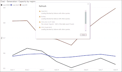

Ashish,
I am having problems refreshing the report after creating a new table by appending the tables.
Any suggestions?
refresh fail after appendrefresh fail after append
Look at the third item in the refresh window of your image.
