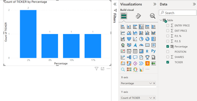

What I am looking for is a chart like this:

Hi @mrData,
You'll need to first define your x-axis column group, for example, ROUNDDOWN to group the percentage.
And then you can put it in the chart to count how many records in each group.
Share the demo file here. Thanks!
You can add it in DAX formula.
Close the Power Query, click on table and add a new column. Thanks!
mrData
I got it working now but it's not that visually clear.
Can I also get a line in like this where you can see what the overall percentage curve is:
Does this make any sence?

Hi @mrData,
I get an error when adding a new column like that:
Here is the error:
