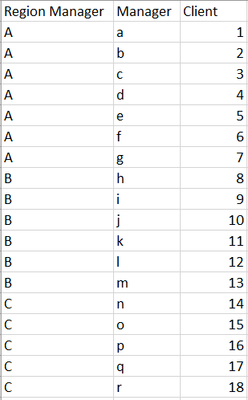

I am trying to build a report where when users log in, their email filters their view automatically so their only see their or their staff's data.
I used PRINCIPALUSERNAME( ) as a measure to automatically show the email of whomever is viewing the report. I then used that as a filter for a second visual with all of the company's emails so it only shows the user's email. The second table works so that table pulls up only the viewer's email.
User = USERPRINCIPALNAME()
User Filter = IF(SELECTEDVALUE(Staff_Member[Staff_eMail_Address])=USERPRINCIPALNAME(),1,0)
Next, I have a third table that has a list of all of area managers and the local managers. When I click one of the names on the managers' table it filters a fourth table to only show their clients served.
**How can I get the second table (emails) to autmatically fitler my third (mangers') table so it filters the fourth table and they only see their stafff's clients?**
An example management structure looks like this where I only want regional manager A to log in and see managers a - g and their clients 1 - 7 while manager a would log in and only see client #1.
Is there an easier way to do this? The goal is to let whoever logs in only see their clients or the clients of those they supervise.
