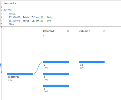

Daniel29195
@mariaschmieder
you can check the calculation in a decomposition tree base on the level you are on :
check example below :
in able to do this, you can use ISFILTERED()  or ISINSCOPE() functions .
let me know if this helps .
If my answer helped sort things out for you, i would appreciate a thumbs up 👍 and mark it as the solution
It makes a difference and might help someone else too. Thanks for spreading the good vibes! 🤠
