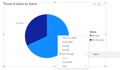

You have to create a measure to count the number of rows so that it can be formatted to show the thousand separator. I'm not sure how the measure you have tried looks like, but a measure is able to be used as a drill-through field. I have created a sample file attached at bottom. Below are my key steps:
Assume that you want to count based on "Status" (text type) column in below table,
You can create the following measure and add it to the pie chart. Select this measure and select "," as the thousand separator in Measure tools.
Count of status = COUNT('Table'[Status])
Then create a page 2 as the destination page of drillthrough. Add [Count of status] measure to the drill-through fileds well on page 2.
Return back to page 1 where the pie chart is, you will be able to drill through to the page 2.
Hope this helps.
