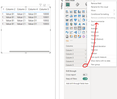

I've added the columns to the table visual, but the values are being summarized by default, and I can't see an option to display them without summarization. Here’s what I’ve tried so far:
  1. Added all columns to the table visual.
  2. Set the numeric column to "Don't Summarize".
Despite these steps, the data still shows only the columns without values or summarizes the numeric field. What steps should I follow to display each row of data without summarizing?

Hello @PBI_learn_NK
is this result match to your need?
Hope this will help you.
Thank you.
Thank you, Irwan, for your suggestion. I have already applied the "Don't Summarize" option for the last numeric column, but my goal is to display the first four columns with unique values in a single row without repeating the same values across multiple rows.

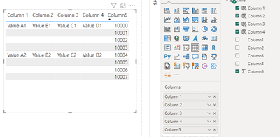

Here’s an example of my desired output:
Currently, when I add all columns to the table visual and set the numeric column to "Don't Summarize," I still
see each row repeated with the same values in the first four columns.
Could you please advise on how to achieve this display where the first four columns show unique values in a single row without repetition?
Thank you for your assistance.

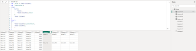

Hello @PBI_learn_NK
not sure if this is the most efficient way, but here is the easiest way that i can think.
Also I added some value in your table just incase you need to differentiate value in those column (1-4).
Since you want to put value in all column at the lowest value of Column5, then you need conditional if to make them blank. Tabel visual will show all value in your column and matrix visual seems not match to your need.
Column 1 =
var _Value = 'Table'[Column1]
var _LowestValue =
MINX(
    FILTER(
        'Table',
        'Table'[Column1]=_Value
    'Table'[Column5]
Return
IF(
    'Table'[Column5]=_LowestValue,
    'Table'[Column1],
_Value is used for defining value in Column1
_LowestValue is used for looking the lowest value of Column5 with exact same value in Column1
Conditional if is used for making blank value for every same string in Column1 (the logic is if the value in Column5 is not matching to the lowest value of Column5 then it is blank).
Last step is do this for Column2, Column3, and Column4. Just copy from Column1 and change Column1 into working column (let say you are working on Column2 then change Column1 into Column2).
As I said, this might not be the most efficient way, other Power BI expert might have another idea how to achieve your need.
Thank you.

Hello @PBI_learn_NK

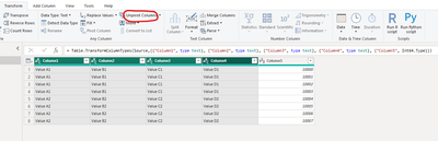

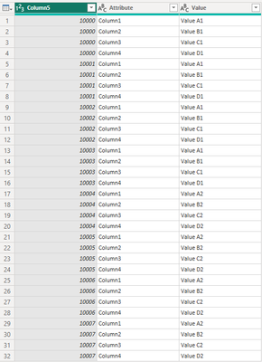

if you have a lot of column then the only choice is merging them in Power Query first.
1. Select all column, then choose unpivot column
2. it will merge those column into one column
3. Create calculated column and use the previous DAX to make blank value

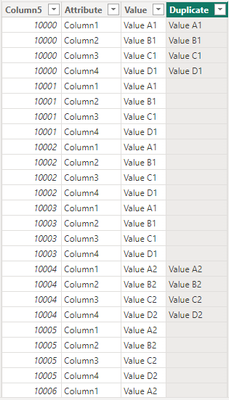

Duplicate =
var _Value = 'Table'[Value]
var _LowestValue =
MINX(
    FILTER(
        'Table',
        'Table'[Value]=_Value
    'Table'[Column5]
Return
IF(
    'Table'[Value],

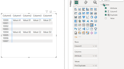

4. Plot using matrix visual
This way should accomodate with your multiple column data. However, the row seems not be able to be moved to the right side so the value of Column5 is on the left side. And this trick will need you to change your table structure (merging them into one column).
Thank you.
