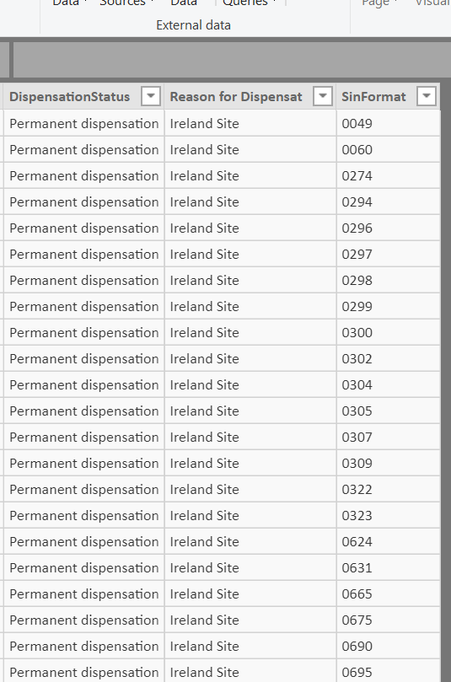

The below info is from my dispensations table:
The 'Sin Format' column is the unique site ID.

What I am trying to do is filter the 'Dispensation Status' column in the Dispensations table to show only 'Temporary Dispensations'. There should be 168. I can do this fine so that the table shows 168 'Sin Format' numbers only. However there is no site name stated in this table so you are unable to see which number relates to which site. The site name is shown in the Timebase table in the 'Site Worked' column.
When I drag the 'Site Worked' field into the table, for some reason instead of showing 168 sites, the table only shows about 50 instead of 168.
Any ideas why it is only showing some but not all the sites?
Thanks.
JD
