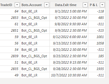

Hi, I would like to calculate the MAX drawdown for several trading strategies. What I get correct so far is Cumulative Profit, CumProfitByDate.
I have Peak and Valley "Kind of" worked out but I need to find the Max Drawdown, (the maximum observed loss from a peak to a trough of a portfolio, before a new peak is attained).
CumProfit = SUMX(_1_Master_Trade_Combined, _1_Master_Trade_Combined[P & L])                                         (Works)
CumProfitByDateTime = CALCULATE([CumProfit], FILTER(ALLSELECTED('_1_Master_Trade_Combined'), '_1_Master_Trade_Combined'[Data.Exit time] <= MAX('_1_Master_Trade_Combined'[Data.Exit time])))               (Works)
PeakByDateTime = MAXX(FILTER(ALLSELECTED('_1_Master_Trade_Combined') , '_1_Master_Trade_Combined'[Data.Exit time].[Date] <= MAX('_1_Master_Trade_Combined'[Data.Exit time].[Date])), [CumProfitByDateTime])
*** PeakByDateTime ******  (Partially works, only giving me the highest peak, I need the peak  beofre the valley where the difference will be the max)
ValleyByDateTime = MINX(FILTER(ALLSELECTED('_1_Master_Trade_Combined') , '_1_Master_Trade_Combined'[Data.Exit time].[Date] >= MIN('_1_Master_Trade_Combined'[Data.Exit time].[Date])), [CumProfitByDateTime])
*** ValleyByDateTime ******  (Partially works, only giving me the lowest valley, I need the valley after peak where the difference will be the max)
Max_DD_Peak_Valley = [PeakByDateTime]-[ValleyByDateTime]                       ****No working, only giving the Delta from highest PEAK to Lowest Valley, I need the maximum observed loss from a peak to a trough of a portfolio, before a new peak is attained).
My Trades table:
Result so far
Max DD = the maximum observed loss from a peak to a trough of a portfolio, before a new peak is attained). see below picture
