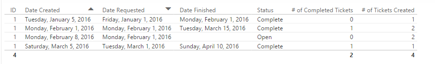

    Test table:
    # of Completed Tickets =
    var temp= Calculate(Countrows(TestTable),FILTER(ALL(TestTable),COUNTX(FILTER(TestTable, [Status]="Complete"&& MONTH( TestTable[Date Created])=MONTH( EARLIER(TestTable[Date Finished]))),TestTable[Date Finished])))
    return
    if(temp>0,temp,0)
    # of Tickets Created =
    var temp= Calculate(Countrows(TestTable),FILTER(ALL(TestTable),COUNTX(FILTER(TestTable, MONTH( TestTable[Date Created])=MONTH( EARLIER(TestTable[Date Created]))),TestTable[Date Created])))
    return
    if(temp>0,temp,0)
    Result:
    Notice: ‘# of Tickets Created’ measure displays the total tickets created in the same month.
