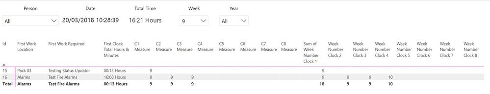

This doesn't filter out visually to adjust the other columns. To show you what I mean, with 9 filtered on Week it doesn't adjust the Total Time card total and still shows the ID lines which aren't valid:
When I filter by Week Number Clock 1, it removes the excess and adjusts the Total Time
The final aim for the report is that it acts as a time sheet so I could select week 9 and show what jobs I worked on that week and the time spent working on that week.

I've managed to have a work around but creating this table:
This allowed me to use this filter in each of the Sum Clock Times:
Which filters the total time card I have how I wanted but not the main display table on the reporting screen
My next step is to also get the times to filter by person and in an ideal world get a filtered table to allow all of the corresponding jobs to be shown as filtered by the week number and person assigned to
At the moment I have this monstrosity
The individual tables are for the corresponding week numbers but the main week number slicer that adjusts the time doesn't affect the tables. The person slicer affects all the tables but not the total time
