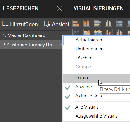

Hi @raymond,
By my test with your pbix, it seems that you create the bookmark button so when you click the button, it will show the filter you set as bookmark.
Best  Regards,
Cherry
Community Support Team _ Cherry Gao
Ahhh, I can feel this epiphany. A simple click to exclude filters from the bockmark.
Thank you so much for getting through to this and even posting you solution afterwards in an easily understandable way
