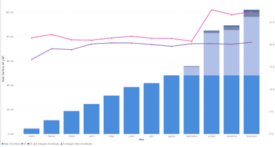

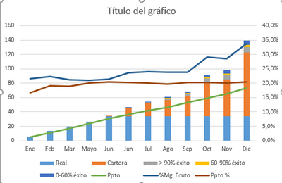

Is there a way in a graph of stacked columns and lines, indicate which axis one of the lines refers to? I attach a graph created in Excel where the Ppto line refers to the axis on the left and the rest of the lines to the axis on the right.
But in Power Bi I'm not able to represent information in the same way because the PPTO line aligns to the right axis. Attachment capture without the ppto line:

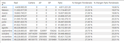

Data table attachment:
