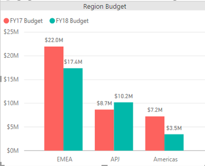

I get inaccurate data when I try to compare two years worth Budget Data across different 'Areas' ('Areas' = APAC, EMEA, Americas). The sources of data are 2 different Sharepoint Lists, the visualization's output values differ depending on which Table i choose the "Axis" field from (see screenshot below)

FY17 data is correct but FY18 is incorrect when the 'Axis' field is 'Area' column from FY17 table
'Area' field is from FY17 table
FY18 data is correct but FY17 is incorrect when the ''Axis' field is 'Area' column from FY18 table
'Area' field is from FY18 table

Hello @GilbertQ & @v-chuncz-msft,
Apologize for the delayed response, I was trying out your suggestions -
@GilbertQ your suggestion to append the two tables and then compare the data worked.
I tried the other suggestions but they didn't work -
1. Change the cross filter direction on the relationships - FY17 Budget Data and FY18 Budget Data from BOTH to SINGLE?
2. Try to drag "Area" field from table Sites.
p.s. i also noticed the "Site" column of FY17 table had few extra entries that wasn't in "Site" column of FY18 table; corrceted this but the issue still persisted.
I used the "Combine" options from the PowerBI Desktop App (Query Editor) to append the two tables.
Once i combined the 2 tables and created 1 table there was no relationship to manage so everything became easy.
Thank you both for your suggestions.

Hi @aknair
Can you change your cross filter direction on your relationships to the FY17 Budget Data and FY18 Budget Data from BOTH to SINGLE?
Also you could possibly Append the Tables together, and then create One measure and use the Year column (If you have it to slice the data?
