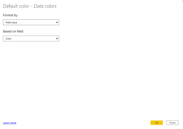

Build a bar chart and use FX in Data color in Format.
Select Field value in Format by and based on color measure. Then select ok and transform the bar chart to line chart.
Result is as below.

In addition to 's reply, I will show the way in details.
Firstly, I need to know how did you get the reference line. Is it an average line in visual analysis?
If you want to show different colors to distinguish whether the value exceeds the average, build a measure as below.
Color =
VAR _AVERAGE = CALCULATE(AVERAGE('Table'[Value]),ALL('Table'))
IF(SUM('Table'[Value])>_AVERAGE,"RED","BLUE")
Result is as below.

@weijunawj , One way is to create conditional formatting on bar visual and convert back to the line.  But if the other line is not avg line and is measure it might not work
Color  =
if( [Value] > [Avg Value], "Green",
"Blue"
Use in conditional formatting with a field value option
or create a measure and use on tool tip
Color  =
if( [Value] > [Avg Value], "Above Avg",
"Below Avg"
