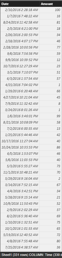

Table:
Measures:
Time(WholeNumber) = HOUR(MAX([Date]))*10000+MINUTE(MAX([Date]))*100+SECOND(MAX([Date]))
Time(Decimal) = HOUR(MAX([Date]))+MINUTE(MAX([Date]))/100+SECOND(MAX([Date]))/10000
Notice: When I use calculate column to show the value, I found the values will auto summaried on the visual, so I use measures to instead.
Create visual.

Hi @gmarkc,
As smoupre said, currently power bi desktop not support display duration at Y-axis. smoupre's solution seems well, you can try it on your side. For your requirement, you can also vote this idea below:
field of "duration" type
In addition, you can take a look at below method(convert the time format to Numeric):
Table:
Measures:
Create visual.
Xiaoxin Sheng
