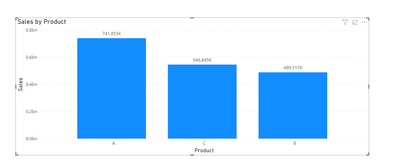

@Anonymous
Is this what you are looking for? You can choose the display unit when you are creating visuals.
yes this is what i used ( agreat function, but a major default)
