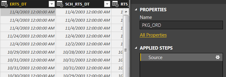

I am using a direct query and I cannot use the formatting options for a date.
I am trying to create a report that shows when a unit is supposed to start (DD/MM/YYYY).
However, my data from my direct query is in a format with time added (DD/MM/YYYY HH:MM:SS).
So all of my data has 12:00:00AM on the end, this is taking up too much room on my report, and is not needed.
Everything I have tried so far I get "Not supported in Direct Query Mode".
Please help.

Errors: 1. This step results in a query that is not supported in Direct Query mode. Switch all tables to Import mode
Solution: Don't change the data type while loading(tranforming )data. First load the data using Direct Query option without transforming and then do the following to change data type of your data.
Go to "Data Modelling tab"-> "Select or click on the Query or table you loaded using Direct Query-> Select the column that we need to change the Data type and format-> then go to an option in topmost corner under Modelling tab to change the column Data type and format.
2. This table uses DirectQuery and cannot be shown
Solution:
If we go to Data modelling tab in the Left corner below chart tab to change any column format, It will not show the table as we used Direct Query to load data from the database. It shows as" This table uses DirectQuery and cannot be shown".
If we need to change the format of the column that is loaded using Direct Query, We need to go to "Data Modelling tab"-> "Select or click on the Query or table you loaded using Direct Query-> Select the column that we need to change the Data type and format-> then go to an option in topmost corner under Modelling tab to change the column Data type and format.

Using direct query mode, power query changes may not apply but can work on model.
you can go to the modeling viewand go to the table, click on the column name which need to change the date format, right side in the properties pane you find general, formating, advanced options. In format option you can change the date type and date format.
