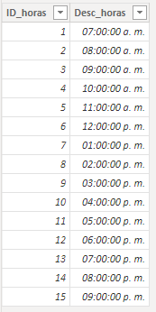

My Catalog of hours

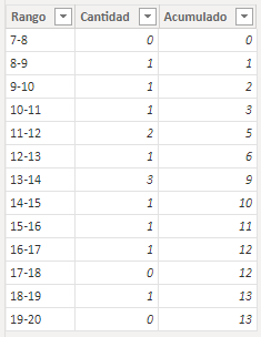

How to show my cumulative closing agreement with the range of hours (this I generated manually, for the example)

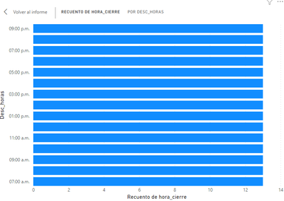

As you can see my graph (All the hours mark me 13, because it is the total of queries I have, but it does not report the cumulative sum of closures per day)
As you should see... Increasing from 0 which is how you start the account to 13 which is the total of my queries
