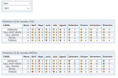

Conditional formatting compared to the previous month
Good morning
I have a query: Is it possible to incorporate conditional formatting icons to an array that has as columns the months of management, rows a data "x" and as values the maximum of this same?
I am trying to perform this task but it always pulls me as BASE DATA of the values, the start of the time of the DATE field, when what I need is that the icons show the change with respect to the previous month:
For example, in the row "AGNCIAS" for the month December and January 2021 you should have an AMBER icon, while for February a RED icon because it increased by 1 compared to January, then for March, return to AMBER because it remains with respect to February.
Then the GREEN icon should appear for everyone who shows a number less than the previous month.
Is it possible to perform that task? because as far as I have been able to search, it only allows me based on the beginning of the numbers in time.
Thanks a lot!

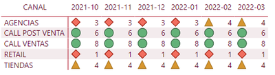

    Hi Syndicate_Admin ,
    I have created a table for test:
    If you want to compare the value of current month and previous month, as set different icons for them, please try:
    Icon Measure =
    var _previous= CALCULATE(SUM('Table'[Value]),FILTER(ALL('Table'),[CANAL]=MAX('Table'[CANAL]) && FORMAT([Date],"yyyy-mm")= FORMAT(EOMONTH(MAX('Table'[Date]),-1),"yyyy-mm" )))
    return SWITCH(TRUE(), SUM('Table'[Value])>_previous,"SignMedium", SUM('Table'[Value])=_previous,"SignLow","CircleHigh")
    Output:

      Thank you very much for your help, I have tried and the solution is valid. Just to tell you that I found another solution to get the month-to-month comparison that was through a quick measurement (month-to-month variation) and associating the dates to a calendar table, that is, I do not take as a basis the dates of my initial table. That helped me and now I can get the results from month to month:
      Best regards!!
