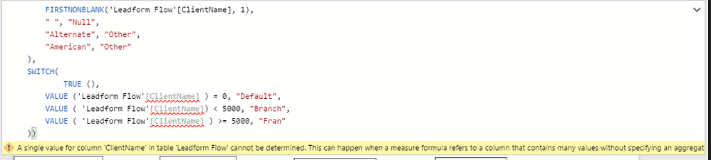

I received this error after creating the formula.
Any help?
Sean
This error indicates you are creating a Measure instead of a column.
Make sure you are creating a column Smiley Happy
Thanks! I updated it to create a column, but it's still giving me this error:
Sean
@Anonymous
If you are creating a NEW COLUMN - the formula would be evaluated on each row and you would not need an aggregator
as the error message advises because on each row there's only 1 value
Thanks! I got it to work perfectly 🙂 You're amazing!
