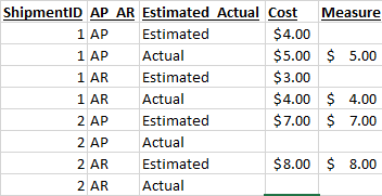

I think I was unclear about what I was looking for in my original post. Here's an example of the expected output for the new measure. The goal is to be able to remove the Estimated_Actual filter/column and not have Cost aggregate values from that filter together.
Hi @Anonymous
Try this measure:
Measure 4 =
VAR flag =
IF (
SUM ( Sheet6[Cost] ),
FILTER (
ALLEXCEPT ( Sheet6, Sheet6[ShipmentID], Sheet6[AP_AR] ),
[Estimated_Actual] = "Actual"
<> BLANK (),
1,
0
IF (
MAX ( [Estimated_Actual] ) = "Actual"
&& flag = 1,
MAX ( [Cost] ),
IF ( MAX ( [Estimated_Actual] ) = "Estimated" && flag = 0, MAX ( [Cost] ), " " )
Maggie
