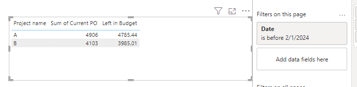

Hi Anonymous ,
Based on your description, I have created some examples for you to solve your problem. Here are a few steps and notes to help solve this problem.
Sample data:
1. Add a measure. Ensure that "Left in Budget" is using a measure, if it is using a calculated column it will not dynamically update based on the filter context.
Left in Budget = SUM('Table'[Current PO]) - SUM('Table'[Chargeable Time Logged])2. Add a DateTable to create a relationship with your data dates. Incorrect or missing relationships may cause the filter not to apply as expected.
Final output:

Hi Anonymous ,
Sample data:
Left in Budget =
Final output:
How to Get Your Question Answered Quickly - Microsoft Fabric Community
If it does not help, please provide more details with your desired out put and pbix file without privacy information.

Hi Anonymous ,
I would be happy to answer any further questions you may have, your data seems to be on two tables. You can follow the steps below:
1. You can indeed add the calculation column [Chargeable Hours] to convert the time as you have done and then *134 (hourly rate).Chargeable Hours = 'worklog'[Chargeable Time Logged]/3600*134
2. Create a many-to-many relationship between the two tables.
3. Modify the measure.Left in Budget = SUM('Table'[Current PO]) - SUM(worklog[Chargeable Hours])Final output:
